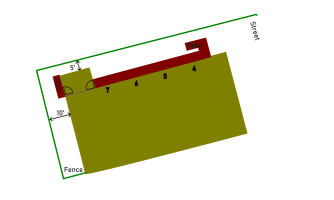

We've got a 1960's building in California with a primary stair, and smaller rear stairway made of wood, presumably to meet egress codes at the time. The secondary stair serves four single bedroom units. None of the units have sprinklers.
The stair is in poor condition.
The building is 10 feet (well, 3 inches less) from the property line, the stair extends into the ten foot setback.
The setback is concrete and used for garbage, nothing else (wasted space).
The town has said that repairs to the stair are impossible, would have to be fireproof anyway, and they won't approve a variance to the setback.
The town does not have a suggestion, just a set of fire and zoning rules that seem to rule out anything nice.
A metal spiral staircase would meet need, not code.
The town has NOT, yet at least, complained that the 2nd egress goes through two unlocked doors and a storage area.
The town claims there's no building permit for the 2nd egress stair, but without evidence. On the contrary the physical evidence suggests it's original to the building.
Thoughts, other than wait for single stair egress to be approved?

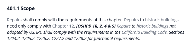

The CEBC (California Existing Building Code) based on the IEBC does touch this topic.

By the way, your illustration does not provide a dimension between the stairs and the property line. You only indicate that it is closer than 10, but did not provide the actual minimum clearance dimension. What is it?

1) It's a San Francisco East Bay Charter City, I don't want to speak poorly of.
2) The existing rear wall of the building is ~10 feet from the property line, in a 10 foot rear setback district.
The existing stair is about 40 inches deep (36 inch clear treads).
The bottom tread of the stairs encroaches about 7 inches into the 5 foot side sideback.

4. Based on what you wrote in post #8, is this an accurate drawing of your stair setback dimensions?
That's correct in schematic.
The actual distance from building to rear fence is 11 feet.
The survey says the distance from building to side property line is 5 feet. To the rear property line is 9.72 feet.
The rear is 100% covered in apparently original concrete, which surrounds the stair footings (more forensic evidence it's an original stair structure).

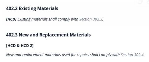

2. What does the city's municipal code or zoning code say about repairing "nonconforming buildings"? For an example from Berkeley, see here: https://berkeley.municipal.codes/BMC/23.324.050

California adopted the IEBC.
On a quick read, it looks to me like the IEBC operates pretty much the same in California as it does in the rest of the country. Rebuilding an existing stair that has deteriorated, in its original configuration, is a repair, not an alteration. The general rule for repairs is that materials permitted at the time or the original construction are allowed, as long as the repairs don't make the structure less safe.

I was asked in a private message to post a photo of the stair in question. Here it is:
The jurisdiction is a charter city in the San Francisco Bay Area. The department objecting to stair replacement is the Planning Division of the town, on setback grounds. The architect did ask the planning division to cite the basis of their objection which they apparently would not do in writing, but did verbally say it was based on the setback. The architect prepared a half dozen plans, and was rebuffed on each attempt.
The project won't make it to outside building code check, unless it gets passed by the planning staff.Capture.JPG
