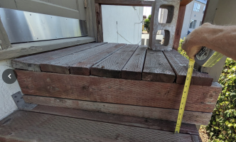

The upper landing is definitely a repair. The stringers seem to be the original.
Treads are uneven with all the repairs. The upper landing to 1st stair is at least an inch greater than the next tread.
Lower landing to first (concrete) tread is at least an inch short.
