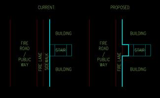

A question came up today at my office about discharging a stair. This is NYS IBC and is a multifamily building. We are trying to determine if your stair can exit onto a public way.
We are trying to determine what the code says not necessarily what is good practice.
There is a road on our property we are creating for garage access. We have a 5' fire lane against the building and stairs from above to the ground floor.
Scenario 1: Stair doors open directly out to fire lane.
Scenario 2: Pulling back stair and creating rated walls/ceiling so stair does not discharge directly into road.
One person in our firm is saying you cannot do either because it's dangerous to someone discharging and getting hit by a car while someone else is saying you can do it as long as you are creating a landing pulled back from the road. See sketch on Scenario 2 below:

So I should be able to pull my egress stair door back (say 44” because my stairs are 44” wide) so they do not encroach in the public right of way.
Sketch is not clear,,,
How do you get a fire truck down a """"We have a 5' fire lane" ??????????????? Or is this for the firefighters to walk on??
But should be no problem with scenario 1.
I take it there is a little set back, so someone does not open the door, and the door gets whacked by a car????
There is actually a 21’ fire apparatus road and a 5’ fire lane in addition to that.
The stair door would be recessed into the building so it didn’t open into the road. In theory, someone would exit the building and be able to stand in that outdoor landing before walking right into traffic.
