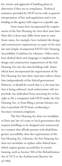

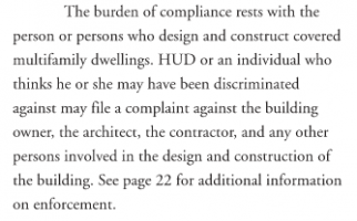

Do you happen to know if FHA requires the owner to maintain the accessible features? For instance have you ever come across an older facility to do work to upgrade it for FHA accessibility thats gotten worn out? I know the ADA requires the features to be maintained.
First of all, keep in mind that the Fair Housing Act Design Manual is all about the design and construction of a building, not about the maintenance of a building. The maintenance of a building is the responsibility of the owner. In this particular case, you would do well at the end of the project to document (photograph) the installed features, and write a CYA letter stating that it is the responsibility of the owner to maintain the accessible features in accordance with applicable regulations. (For what it's worth, some states are going to require the owner to sign a statement of maintenance that gets pasted onto the plan check set. This is similar to agreeing to maintain stormwater compliance, etc.).
Second, design is just one part of the overall Fair Housing Act. Fair housing includes things such as (for example) nondiscriminatory rental policies, which are the responsibility of the owner.
Thirdly, there can be unique situations where the tenant requests a "reasonable accommodation" to modify a building feature beyond FHADM requirements.

Regarding my first statement, see page 2 of the FHA Design Manual:
Page 22:
Page 23 (cont'd)
