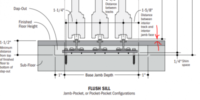

Interesting. In the image below (from page 6 of the brochure), what is the vertical distance between the arrows?In case you are interested, Andersen windows manufactures a nearly perfect FHA sliding door track channel. Its in their big door brochure. Go to page 18 of the linked pdf. You probably already have this.
To be specific, the surveyor would have to gather elevation points every 2' on center in every direction on paths-of-travel, and they survey accuracy should be within 1/100th of a foot.You hire a surveyor.
