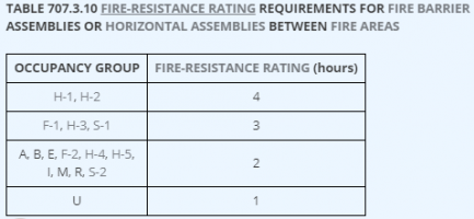

No you can have multiple fire areas with a single building. Fire areas can be used in lieu of fire suppression requirements.
Sure, if separated by a fire barrier. Are they separated by a fire barrier?
Per T707.3.10, it would be required to be of 2-hr fire-resistance.
707.3.10 Fire Areas
The fire barriers or horizontal assemblies, or both, separating a single occupancy into different fire areas shall have a fire-resistance rating of not less than that indicated in Table 707.3.10. The fire barriers or horizontal assemblies, or both, separating fire areas of mixed occupancies shall have a fire-resistance rating of not less than the highest value indicated in Table 707.3.10 for the occupancies under consideration.
