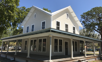

Per this:
8.15.7.1
Unless the requirements of 8.15.7.2, 8.15.7.3, or 8.15.7.4 are met, sprinklers shall be installed under exterior roofs, canopies, porte-cocheres, balconies, decks, or similar projections exceeding 4 ft (1.2 m) in width.
Not required for the roof line on this building,
Unless the plans are not showing everything.
Doesn't meet .2 .3 or .4......Sprinklers required....
Why?
Will our 4' overhang be required to have sprinklers?
8.15.7.1
8.15.7.5 *
Sprinklers shall be installed under roofs, canopies, porte-cocheres, balconies, decks, or similar projections greater than 2 ft (0.6 m) wide over areas where combustibles are stored.
8.15.7.1 only requires sprinklers on the underside of the eave if the roof eave exceeds 4-ft. Per the OP, the eave is 4-ft.
8.15.7.5 only requires sprinklers on the underside of the eave if the roof eave exceeds 4-ft and has combustibles stored under the eave.
Keep the eave at 4-ft and it does not have to be sprinkled.

Apologies for the lack of clarity. Our other design constraints push our upper eaves over 4'. Its similar to the image CDA shared. It seems illogical to have to have sprinklers at the upper eaves in this situation, but as stated .2 .3 and .4 don't except us.
Agree
Do you have a fire sprinkler company you work with??
If so have you asked them the question
If over 4-ft, then I revise my prior opinions (I was under impression they were 4-ft) and agree that they are required.
