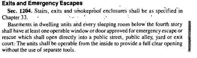

Our fire department was all volunteers and have only in the last few years become a combination department. Currently we have 2-3 firefighters living at our station at any one time. From what I've read in the forum, our sleeping quarter are considered an R2 occupancy? The question has recently come up about means of egress from this area. We have two exits out of the room - one that goes to a common area with two external exits while the other exits into our vehicle bay. It is this second egress that seems to be raising some doubts as it leads to our bay. Are we out of compliance? Trying to sort things out in regard to EERO so any information would be helpful.
Our station is a single story building built in 1990-91 and is not sprinklered.
1988 UBC
Your fire station occupancy classification when it was built is "B" occupancy Division 2 and would have required EERO's when it was built if sleeping rooms where provided
UBC section 503
Hotels and apartments where classified as R-1 occupancies and EERO's where required in sleeping rooms

Thanks for the feedback on the occupancy rating. So if I am reading this correctly at least one of the two exits from the sleeping area needs to open to the outside? At the moment neither exit does and it would be impossible to do so as the sleeping area does not have an external wall.
I don’t know what 1988 Oregon code said about a door from a sleeping room to a garage but here and now that would not be allowed.
I don't disagree with you on that point for sure. Our station was not designed with sleeping quarters in mind as we have only very recently evolved into a combination department with staff spending the night. The room we converted to the sleeping area was the only other room besides the training room. I just want to make sure we are up to code with everything. The code book is very thorough and a bit overwhelming in spots.
I think Joe B. is right, if you now have people living there, you have changed the use and need to bring that area up to the current codes, not the '88 codes.
Are you in a city or a county? Do you have a local building department? They would be able to help you with this, and they would be the best people to talk to since they know the local changes to the code.
If you are in a fairly low population area, the building department folks are usually willing to come out on site and walk and talk and help guide you on things like this.
Under current Oregon code, it seems like the living facilities at a fire station would be Group R-3 310.4 (Buildings that do not contain more than two dwelling units, Congregate living facilities non transient with 16 or fewer occupants). Section 1030.1.2 requires emergency escape and rescue openings in R-3 and R-4 occupancies.
