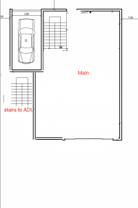

Hi everyone,
I found this thread similar to my situation, but unfortunately the attachments to the original post have been removed, so I don't understand the conclusion here. Did it work out at the end?
To give some context. I am building (designing) an ADU on the second floor of a single family home with an exterior stairway on the side of the lot as the ADU entrance.
Something like this with the first floor being the main house and ADU on top.
The lot is very tight and the I am trying to see if I can put the stairs closer than 10feet to the property line (e.g., 5' away from the side of the lot).
Now my question is whether I can satisfy the fire-rating requirements by making the walls of the main house and probably ADU fire rated. Or maybe by adding walls around the staircase? Or is a complete no-go situation?
Any advice would be appreciated.

Thanks for replying!
It is in Palo Alto, CA. My ADU is supposed to be only on second floor and so I need its own specific stairway. There is the 2story single family home + ADU.
Ground floor with proposed exterior stairway:
I would rather put it as an exterior stairway to not be counted in FAR (avoid making the stairs interior) because I believe in that case it will be counted in ADU FAR (twice) and it will leave me with a very small allowance for building it.
