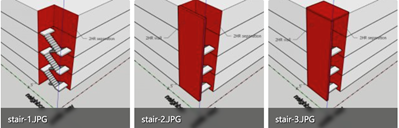

Fire wall to protect exterior stair parallel and close to property line

Thanks a lot. I was also thinking about R302.1. but I am a little confused, so the "exterior exit stairway" and the rule for being 10' away from PL does not apply here? What is my stairway categorized as?
Also, if I move it closer, i.e., 3' to PL, then I assume for fire rating I would need to put walls around it (which one of these options?)

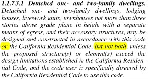

But wait, again, we can arrive at the same conclusion more quickly than that, using the California Residential Code instead of the California Building Code. Look at chapter 1 of the 2022 CBC, "Scope and Administration", section 1.1.7.3.1 - - the choice is yours:
Since your building only has two dwellings, you can choose to ignore the CBC, and just focus on the CRC (as referenced in previous posts), which is probably easier to navigate and understand.
either way, it sounds like your 5' setback will be OK form a life-safety standpoint. (You'll also have to check local zoning codes, state ADU law, etc. that are under jurisdiction of the local planning department.)

My original zoning was R1. Except from the fact that I can go with CRC, I am just curious about the fact that the exception for CBC code applies to R-3, perhaps my occupancy code will change to R-3 based on the added ADU? Please correct me if I am wrong.
Considering the CRC, I will probably try putting the stairway 3' away from PL (based on the allowed encroachments for my zone) and somehow make it fire-resistant based on the following table (maybe adding walls around it will be needed). Any thought or advice would be appreciated.
