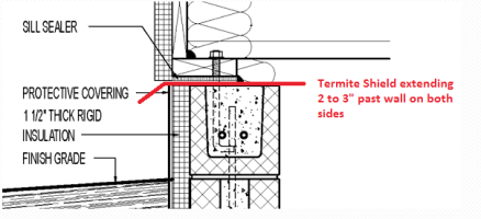

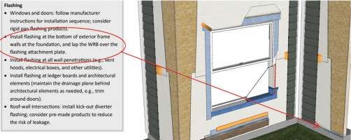

I thought I'd find this already posted but came up empty: is flashing required at the joint of the foundation and framed wall?
A picture is worth a thousand words, so you can see the location and sequence of the flashing but I can't tell if this is just a "best practice" or required by code.Flashing detail snip.png

A copper termite shield is often used in this location. It looks like flashing and is bent downward at a slight angle to keep subterranean termites from creating mud tubes into the house.
