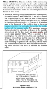

    I spoke with the International Code Council today about "floor area" .. they said the roof overhang / "porch" is not included... I went to the local building department with that information... they told me to pound sand, and next week I will be receiving a fine in the mail and a court date.... I told them I will see them there.

    In addition, I asked the building department if they would be satisfied if I cut the roof off with a 2' overhang... they said yes... so I asked what the difference is between a 2' and a 6' as far as floor area goes... and what the "code" is for maximum roof overhang... they said their isn't one :) Hahaaa...

    "The shed itself, measured from the inside (per the definition of "floor area") is 199 sq/ft. Local building code specifically says"....
    The square footage of a structure is measured on the outside of the structure. I know a few officials that would draw the line at exactly 200 square feet. I am not so inclined....well that is unless I've got a patio cover planted on the side of the shed....but then we go way over the 200 square feet so whats the big deal about a few extra shed square feet.
    For obvious reasons there must be a limit on roof projections from storage sheds. My code limits overhangs to 24". Where you are the limit is achieved by including the porch in the square footage calculation of the structure. We would probably use the same approach in your case because a porch is not an overhang.
    Don't pay attention to these guys that are commiserating with a lost cause. You'll get spanked in court.

    The code is clear
    The space is usable. It does not matter when it was built, or by whom.

    There's really no difference between this and the shed
    This is from the interp manual

    local code does not say "building area" ... it says "floor area"... hence the issue.
