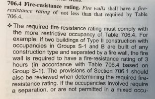

Is the storage space adjacent to a fire wall? If so, that part of the fire wall will need a 3-hour rating. If it isn't adjacent to a fire wall, then the one hour ratig is adequate.
Not accurate.... must design for the most restrictive use within the building. If the S-1 is large enough to be classified (i.e. >10%), then the fire wall must follow Table 706.4 and go with 3-hr rating. See image from commentary below.
the storage space is approx. 200' from the firewall. (it's at the end of the wing). i have the dividing wall between E & S-1 labeled as a 2 hour barrier. Per 508.4 it only requires a 1 hour separation. the wall is masonry and was labeled as 2 hour before so i've left that as is. the fire wall is labeled as 2 hour. i do believe that wall will need to be 3 hour but i want to think through what the implications of that are. the building is being estimated right now and the estimator has enough to go on. the program is still in flux and there are 2 more pricing exercises before this goes out to permit so there's plenty of time to change that wall down the road. my feeling is that if the numbers come in high, the storage room will be cut and this will all be a non issue.
right now my feeling is that it will be much easier/cheaper to change the separation wall between E & S-1 to be a 3 hour fire wall and not sprinkle the storage space. it is a solid masonry wall with no openings or penetrations. i may also suggest reducing the size of the storage space so that it's less than 10% of the floor area and can be considered an accessory use.
