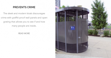

The prevalence varies by location. This may not be a problem in Canada (the subject of the original post), but in towns that do not have a a shared "societal contract" about how to use a 100% public restroom facility that has 100% private stalls, it is very hard to manage.
Look up the history of the "Portland Loo" to find out about the societal challenges they faced.
