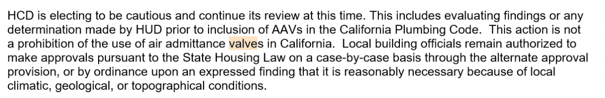

AAVs are not included in the UPC or the CA Plumbing Code But does not prohibit the use.
Just because they are not included does not mean they are prohibited.
CA allows the AHJ, to use discretion, on a case by case basis. This however, does not extend to commercial use.
