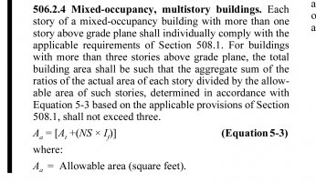

I'm using Ohio Code code:
506.2.4 Mixed-Occupancy, Multistory Buildings
Each story of a mixed-occupancy building with more than one story above grade plane shall individually comply with the applicable requirements of Section 508.1. For buildings with more than three stories above grade plane, the total building area shall be such that the aggregate sum of the ratios of the actual area of each story divided by the allowable area of such stories, determined in accordance with Equation 5-3 based on the applicable provisions of Section 508.1, shall not exceed three.
1
(Equation 5-3)
If someone can tell me where in the code it specifies how to determine he allowable area for a 2-story mixed occupancy building, I'd appreciate it. This is the only section that mentions it, and this section does not specify the use of any equations, the use of table 506.2, or anything else. It says each story shall comply with the requirements of 508.1.
I realize the INTENT is to use equation 5-3 for each story to check area compliance, and because it is not more that 3 stories above grade plane the total building area doesn't really matter because it can't mathematically exceed 3x the maximum allowable if each of the 2 floors comply, but I'd like to understand where this is spelled out.
