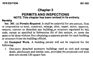

Can someone explain why you would take a 35 year old code exception that is Intelligent Clear and Concise and change it to what the 2018 states which is creating the discussion we are having now. What was the reasoning behind the code changes?:mad:
2012 IRC
[A] 105.2 Work exempt from permit.
Exemptions from permit requirements of this code shall not be deemed to grant authorization for any work to be done in any manner in violation of the provisions of this code or any other laws or ordinances of this jurisdiction. Permits shall not be required for the following:
Building:
1. One-story detached accessory structures used as tool and storage sheds, playhouses and similar uses, provided the floor area is not greater than 120 square feet (11 m2).
ACCESSORY STRUCTURE. A structure not greater than 3,000 square feet (279 m2) in floor area, and not over two stories in height, the use of which is customarily accessory to and incidental to that of the dwelling(s) and which is located on the same lot.

Good points. I keep "history" of IBC 4.10 for same perspective, and go back to 1969s with NFPA 101 assembly chapters. Often only way to understand how we got here.
You really need the code change record to figure this out. It felt that when the CABO OTFDC transitioned to IRC a lot of institutional knowledge was forgotten or lost.
In my part of the country, we didn't change it. Thank the heavens for that, or I would be finding this discussion more disturbing rather than entertaining :) Our amended code currently reads:
Yes.
ADM27-13. It was a two part code change. Part I was IBC, Part II was IRC.
Proponent's reason statement said "The term “used as tool and storage sheds, playhouses and similar uses” is proposed to be deleted because there now
exists in the IRC a definition for “accessory structure”. It is unnecessary to further define the term in the rule as it only serves to add confusion. For example, a small outdoor screen room meets the definition of accessory structure but is it exempt from permits? It poses no more of a hazard than a playhouse or tool shed. It is better to let the definition provide direction. ACCESSORY STRUCTURE. A structure not greater than 3,000 square feet (279 m2) in floor area, and not over two stories in height, the use of which is customarily accessory to and incidental to that of the dwelling(s) and which is located on the same lot.
IBC Committee disapproved it, saying "While typically laundry lists are not warranted, not all small structures should be considered accessory. These examples need to left in the code for clarity."
IRC Committee approved it, saying " The committee approved this code change proposal because they felt that the type of information addressed by this proposal is suitable for inclusion in the commentary to the code, but not in the code itself."
Final Hearing results changed nothing.
Thanks for the info
The commentary does not say a damn thing about it and if it did it is not code and therefore not enforceable.
The definition of accessory structure is now not limited by sq ft and the height is now limited to 3 stories as an IRC structure which is more than allowed under the IBC for an S-1 or U occupancy
As for the 200 sq ft exemption it was for specific structures and their uses now it can be a free for all.
It was a specific limited use exception within the code for Clarity as the IBC Committee noted. The IRC Committee definitely did not think that one through.
