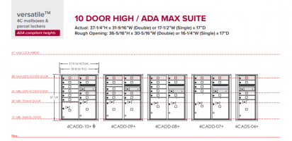

The safest thing to do (but also the one which takes up the most space in plan) is to provide everything within ADA reach range. That way, if a tenant becomes wheelchair-bound and requests a "reasonable accommodation" for mail delivery, you're already set up for accessibility. To make all of it comply with both USPS and ADA, it's as follows:
  • Mailbox key for tenants between 28-48" AFF.
  • Outgoing mail slots between 28"-48" AFF.
  • Parcel locker bottom at min. 15" AFF.
  • Postal worker "arrow" key access between 36"-48" AFF.
This is what manufacturers typically describe as a "10 door high" unit:

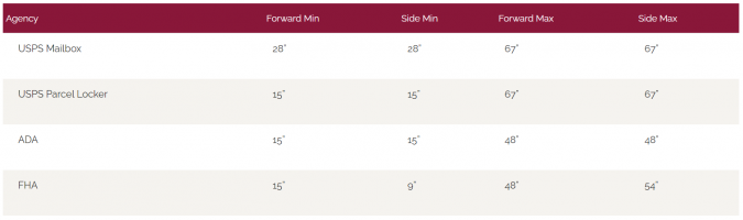

If you do have boxes above 48 inches, the Fair Housing maximum height is 54 inches for a side reach and 48 inches for a forward reach, based on 1986 ANSI A117.1. That applies to mailboxes serving all units in a building with an elevator and all ground-floor units in a building without an elevator.
Yes, the link I provided above includes a chart describing the potential applicable clearances - - see below. If you are doing private housing, your mailboxes probably won't need to comply with ADA (except maybe if you have a mailbox for a leasing / management office). So you just pick the most restrictive measurements from among all the regulations that might apply to your project.

FHA allows side approach clearances between 9-56".
