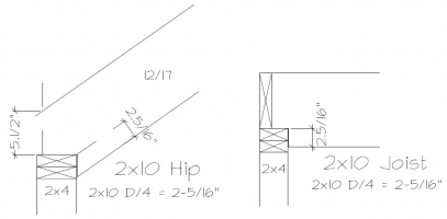

This is a figure comparing 2x10’s notched to the maximum depth of D/4. The figure on the right is code compliant. Is the figure on the left? Many would argue that neither are “proper” or at least ideal and should be avoided. The question is, is this what the ICC is attempting to say? The way we measure the depth of the notch should be related to its impact on the structural integrity of the rafter.
In your second diagram, none of the remaining dimensions agree with the code diagram. Your dimensions are vertical, the code dimension is perpendicular to the top surface of the lumber.

The second diagram has depth dimensions on the hips shown in the lower figures.

Ok, i see the dimensions for the 2x8’s. I’m not disagreeing with your original point, i just wanted to see correct illustrations.

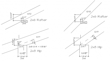

On first read-through, it wasn't clear to me what your diagrams were showing, so in case it helps others:
For rafters of a fixed size at a given pitch, bearing directly on the top plate, using the minimum bearing length will put the top of the rafters as high as possible. The top of a hip/valley rafter has to be in the plane determined by the top of the common rafters on each side. [Well, less the effect of the thickness of the hip/valley rafter, unless you bevel the top.] Then the deeper the hip/valley rafter, the bigger the necessary seat cut and resulting notch depth. The diagrams illustrate this for 2x6 common rafters, 2x8 hip rafters, and 6/12 and 12/12 pitches.
It seems to me most of this effect is from using a deeper hip rafter than the common rafters. For example, just for the common rafters, if you bump one rafter up from 2x6 to 2x8, the depth of the notch in the 2x8 obviously needs to 1.75" greater in the 2x6s, if the tops are to remain in plane. Which is most of the allowable D/4 notch depth of the 2x8.

Thank you Wayne. You summed it up perfectly. Sorry to all. I didn't realize I botched my explanation that bad.
As with a ridge board, the hip or valley rafter must cover the end of the jack rafters coming into it. Therefore, you must increase the depth of the hip member.
Ah yes, R802.4.3. Whose first sentence says "Hip and valley rafters shall be not less than 2 inches (51 mm) nominal in thickness and not less in depth than the cut end of the rafter." Which confused me at first reading in isolation, as I took "the rafter" to mean the only rafter mentioned in the sentence so far, the hip or valley rafter. But based on the similar section for ridges, it means a jack rafter bearing on the hip or valley.
