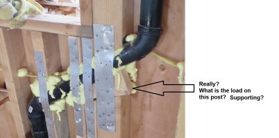

On a recent inspection I noted that the nail plates did not extend 1-1/2" beyond the pipe. This was a tract inspection and the superintendent said that the usual inspector had told him about that but the city wasn't enforcing that code because there was a question if the plate was required to stick up in the attic space. So they assumed that the 1-1/2" was on the vertical and not the horizontal. I pointed out that the code says. The steel nail plate shall extend along the framing member"
My take on it is that the plate shall extend horizontally however, I have encountered the vertical interpretation many times.
I do have a question. "not less than 1-1⁄2 inches beyond the outside diameter of the pipe or tubing." I have understood that to mean that the plate shall extend 1-1/2" past each side of a pipe. For example a 3" pipe would require no less than a 6-1/2" plate. Some have decided that the plate only needs to be 1-1/2" larger than the OD of the pipe.
What say you?

It is there for braced wall hardware. HD? The foam was a nice touch. Note that the honking notches still didn't get the pipe all the way into the wall.
So, the braced frame is compromised. I would require the Engineer of record to sign it off.

It does not look like those are legit plates. Simpsons are 1.5 inches wide, those shown do not look like they areas wide as the studs?nail plate.JPGmet plate.png
Me too. The result is bigger straps. I don't recall the outcome of the example in the picture but it is not unusual to discover that the amount of wall bracing is overkill and the damage to one 4"x4" is inconsequential.
Whether it is or is not inconsequential, should be the Licensed Structural Designer of Record's call, not the inspector.
Have the DoR sign it off or provide a fix. Could be as simple as a Simpson "shoe".
