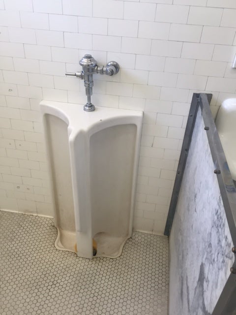

FWIW, that dual urinal is still in use in at least 2 buildings that were originally built in the 1920s, and it is the only available urinal fixture in those restrooms. I believe the fixture manufacturer was Crane. The owner, who shall remain unidentified in this litigious society of ours, has plans to change them out as part of an upcoming building renovation for accessibility.
LOL, it's hard to see in the photo, but there's a solid porcelain "partition" between the two sides of the fixture. It stops a few inches short of the bottom of the urinal, creating a gap where the two sides can share the common drain in the middle.
I suppose you could aim downward at the bottom of the urinal and try to bounce some splatter onto your neighbor.
Anyway, when the owner gets rid of these things, my guess is that some neighborhood bar will try to salvage them as a novelty.
