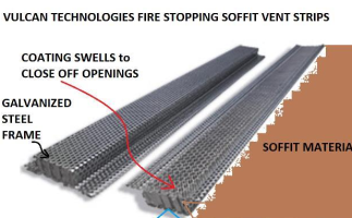

However, on a balcony framed with conventional lumber joists (not open-web trusses), does the phrase "cross-ventilation area" imply at least two rows of continuous vents?
Example: a cantilevered balcony 6' deep, made of 2x12 joists @ 16" o/c. Each joist bay is 14.5" wide x 71.5"long, and has no insulation in it.
A continuous soffit vent like the one shown below runs along the middle of the bay. Because it is going across the entire 14.5" width, is it considered a cross-ventilating soffit?
Or do I need one continuous vent at the back and one at the front in order to get ventilation across the entire 71.5" long direction?

Right. The phrase "cross-ventilation" is not defined in CBC 202.
Maybe the hoped-for air movement in the cavity is achieved not by convection, but just by some hope that turbulent airflow against the balcony on a breezy day will help.
A superintendent on my current multifamily project is asking me the question, because on his last project the inspector made him add a second vent and cited the phrase "cross-ventilation".
How can you have cross ventilation with the vent on only one side?
Good question. It didn't say which way the ventilation has to cross. In post #1 with the Vulcan continuous vent, it cross-vents on the short axis of the joist bay. If the balcony is 6' across, that means that no part of the joist bay is more than 3' away from a vent.
Compare that to CBC 1202.2.1, where the entire top 3' of an attic can be without vents.
So is a continuous vent providing "cross ventilation" if it is continuous across a 14.5" wide joist bay that is less than 6' long?
