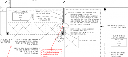

I'm having a hard time finding a code section that addresses the opening perpendicular from each other. separating fire areas required three hour fire barrier so designer is requesting to install 2 separate 2 hour barriers, which I'm okay with. but it seems counter productive if there are 2 openings directly adjacent to each other right outside of the fire rated area. 707.5 seems to only address vertical continuity and doesn't talk about extending that protection beyond or walls perpendicular to each other.

that was my plan for the 2 doors opening to one another. I was more curious for the overhead door to the man door perpendicular to each other immediately adjacent to where these too buildings are touching on the inside corner of the exterior walls.
So a 3 hour barrier is required due to exceeding fire areas of 12000sqf. Fire barrier for s-1 is 3 hours. Trying to avoid needing sprinklers. And they are doing a separate building because they found a good deal on a kit building before thinking of the requirements. If the code is okay with 2 2hour fire walls with 2 90 minute doors equaling a 3 hour fire wall it’s logical to say it’d probably work for fire barriers too. Originally they were going to separate these but they were running into FSD issues that would requires more fire walls. They do not need fire walls because with the buildings combined they are within the allowable area with area increases.

Assume a property line between the two structures. Table 602 requires 2 hour walls for each exterior building wall with a 0 Ft. fire separation distance. However Table 601 is also applicable depending on the type of construction of the kit building and if the 2 hour wall is a bearing wall or not. Keep following the code path, check all footnotes and exceptions and you will likely end up in IBC TABLE 716.1(2) (2018 edition) which would make your design above code compliant.
