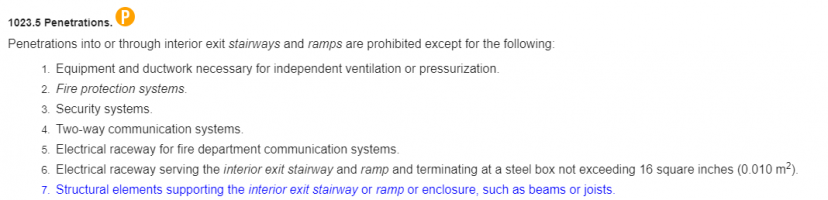

I have no idea what point you're trying to make about stair shafts. Those are fire barriers and require both protected openings and penetrations. The only easing up was allowing penetrations on the exterior membrane. You still need a penetration firestop if you exceed the exceptions in 714.4.2. You have ALWAYS been allowed to penetrate the shaft walls with structural elements that support the stair.
Not in CT.....And this will now allow I joists or open web trusses to penetrate and become the landing cantilever with not firestopping what so ever as th floor ceiling assembly has the same rating as the exit enclosure.....With shafts you could, but not with exit enclosures....Different....
You can have floor assemblies project into stair shafts if they have the same or higher rating. Think of a landing in a PT concrete building. Enclosures for stairs are to be constructed of fire barriers OR horizontal assemblies. Typical shafts in concrete buildings are infill walls between the slabs or spandrel beams. 100% OK.
I think you're confusing the intent of 1023.5. It isn't discussing penetrations of the fire barrier or horizontal assemblies of the shaft but the stairway itself. 707.7.1 further reinforces the intent prohibiting "Penetrations into enclosures". The intent is that you can't have anything unrelated to the shaft penetrate the stairway. You can have a beam penetrate the membrane for a landing inside the shaft. It must be firestopped but it is allowed and always has been in my recollection.

I would argue that the "enclosure" starts at the beginning of the rating and No penetrations are allowed on the inside per the exception.....Which again, makes no sense to me...But may be the route I need to go to prevent the situation with the cantilevered landing penetration...

First, I'm referencing 2018.
The enclosure does start at the beginning of the rating but 1023.5 is limiting penetrations that go into the stairway. Again, the intent is to keep anything unrelated to the shaft out of the shaft. They don't want pipes or anything else running into the stairway and then back out that don't serve the stairway. There is no prohibition of penetrations that serve the stairway, like beams supporting the landings.
You don't need to prevent landing penetrating your shaft is they have the same rating as the shaft. They ARE part of the shaft. Shafts don't need to be straight, they can jog, go sideways, go at an angle, whatever. They only need to maintain a continuous rated enclosure. Again, the PT example; there are thousands of PT buildings with mid floor landing that are hung from the slab above with hanging columns inside the shaft wall and beams that penetrate the inside of the shaftwall (firestopped) to connect to the hanging column. That is the typical detail. It is, and always has been, acceptable under IBC.
