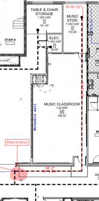

railings onto 1'-2" high stage
ccollings
Sep 4, 2020
107
Cleveland

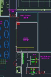

i have a stage in a pk-6 school. normally the stage will be used as a music room and will be closed off by a folding partition and only opened during special events. the stage is up 2 steps (1'-2"). I'm trying to figure out, if i need railings to get onto the stage, and how to do them if i do. the steps do not project past the line of the wall. the front of the stage is a passage space so i don't want anything that will project into it.
In looking at your floor plan, why do you need steps ?
There is access to the Stage Area by the ramp.
when the space is used as a music room then it can have 1 exit, but when it's used as a stage then i don't think 1 exit is enough because the occupancy will be over 49 people.
I think what north star is getting at is that at 14" in height there's no need for additional stairs because most people could egress directly off the stage without steps. But to answer your original question you would not need railings for 1 or 2 steps, as far as I know.

If you add stairs to the stage, handrails are required, on both sides by IBC, on one side by NFPA.
I advise against inset steps - notched into stage in plan - as they are a well known hazard. People move laterally at the stage edge while looking into audience.
Consider letting air wall store 5'+ from stage right wall and building steps there, with door and landing at cafetorium floor level. The ramp already makes a biparting curtain not possible.
Given the size of the stage opening / aperture, it looks like the usable part of the stage is 749 SF or less.
Can you use the exception in 1004.5 to post a reduced occupant load of 49 or less?
The chances of an event on this stage exceeding 50 is substantial. It's the nature of stages, especially in schools, to include everyone. It would not surprise me to see a 100 or 150 person choral event.
Back to the rails, perhaps you were proposing a continuous step across the stage opening to cafetorium. In that case, I believe a handrail at each side or send if that step complies. I don't believe rails every 60" are required. Plenty of capacity in ramp and the 30" at each end of the step.
Keep in mind if utilizing this step for egress, you can never have a main curtain that closes the opening.
I'd also recommend 3 risers, not 2; 7" is just too high in this setting.
Also, the stairs to stage would require an equal accesible route, not one through a door to the side.
ccollings, ...I do not know if we answered your question or not.
In reading the other responses, it seems reasonable to expect an
Occupant Load of over 50 ( at times ).....With that in mind, some
type of stairs and another Accessible MOE is needed........The
design & location of the stairs and the 2nd Accessible MOE are
the next problems.
the next problems.
you answered my question. i need railings. so now the tricky part of designing them.
Very similar condition on one today. The actual area of the stage/classroom is 799sf². As proposed, access is via a ramp only, and the elevation difference is 12". There is also a "music storage room" behind it and accessed only through it, but the total area is < 1,000sf². They assign an OL factor of 20-net for a classroom. As bill1952 states, the chances of more than the calculated 40 occupants is good, but what code basis do I have to assign it differently? And, by definition, this would be considered a platform, not a stage, although I don't think there is a material difference based on the size. I know this area could be used for a recital, a choir event, or even a Christmas play (now it's a stage), but I still have no direction on the occupant load for it. Do I assume the most restrictive as standing space (in my mind a choir event) and go from there? The viewing area doubles as the cafeteria, and it is calculated at the worst case of 7-net.
FYI, the CPET from the most remote point to the bottom of the ramp (the point of choice) exceeds 75' so they are going to have to come up with something anyway.
The BO could consider a posted, artificial reduction by signage, but without a firm allowance it is still subjective and to be considered I would want a starting point.
For those of you well versed in stages and platforms, how have you considered the OL?
One more thing. 410.1 says the entire section applies to areas with stages or platforms, so by that 410.4 would require separation of the from the storage room, and 410.5 would require the MOE be on the opposite end from the ramp. However, each of those sections specifically prescribes the requirements for a stage, so if defined as a platform, do these sections not apply?
Sorry, 2021 IBC, but same in the 2018.
Table 1004.5, 2nd from last "Stages and Platforms" 15 net
So ~54 occupants?
2nd ramp or steps I'd guess. I'm surprised it exceeds 75'. Is that a straight line from opposite corner to top of ramp and down? I see people follow along wall and I don't.
ps: I am embarrassed I had to look up the occupant load factor, and it was added as a result of my proposal. ;)
410.4 is a little messed up I've been trying to fix it for a couple of cycles but unsuccessful. But yes, the storage room should be 1 hour iirc.
I'm sorry - not understanding MOE question and "opposite end". Is ramp inside storage? Is there no stage to audience floor path? I'm probably missing obvious.
I think I'd "soften" line between stage and storage, just label it all stage, and maybe that would solve problem?
Still seems over 50 requires 2 MOE? Hard for me to offer much without better sense of plan and constraints.
So ~54 occupants?
Wow, totally missed that. 15-net it is. I'm embarrassed too, because I specifically looked for this in the table and completely skipped it, assuming it wasn't there.
I think a solution to the CPET could be a two step stair off the landing, but at 15-net the space requires another MOE, separated by 1/3rd the distance. I really don't want to make this an issue for the extra 4 occupants. For OL, a solution is to the make the storage and electrical room a little bigger by robbing 75sf² from the classroom, which would result in a combined OL of 49. But, if they push back, the BO will allow an artificial reduction by a placard.
I would suggest adding a door against south electrical room wall with a landing at main floor level, 2 risers. I think they'll find it convenient as well, to be able to get from "stage" to "house" on the side of stage with wing space.
You could add steps of ramp landing opposite ramp.
The users are very likely to add a step from house to stage in main proscenium opening. They just do, over and over. Of course that then violates accessibility regs which is why I presume you didn't. Hopefully they'll put a handrail on it.
Otherwise I don't have much to add.
Appreciate the suggestions. There are lots of ways they can approach this, my comment will let them know what needs addressed and they can figure a way to go. I always try to anticipate the solutions up front, but I don't share them, at least not in writing. My first thought and the easiest path in my opinion is a door and steps through the other table and chair storage room, which would address both issues. The electrical room is pretty tight, and didn't consider it because I think that may open up other issues. It would be easy to put a step and rail in on the front, but it would be pretty awkward when the moveable wall is closed, but they can consider that as well. The steps off the end of the ramp solves the CPET, but not the exiting unless they reduce it in some method. End of day, I think there are some easy fixes if they apply a little critical thinking.
I see several issues with this layout as shown. First of all, it has generally been agreed that the occupant load of the Stage/Music room exceeds 50 persons, so the door at the bottom of the ramp as shown swings in the wrong direction. Even if the steps off the front of the stage were to be considered as part of the means of egress, the moving wall at the top riser is not a code-compliant component of means of egress. (Even if the moving wall were to have a door in it, a door at the top riser is not permissible.) The steps are required to have handrails on both sides. One last thing to consider is that, if this is an NFPA jurisdiction, the tread depth is required to be 13".
A suggested solution: Pull the folding partion "south" toward the stage opening far enough to provide a code compliant stair and landing in between the folding partition enclosure and the wall that separates the Stage/Music room from the Table Storage room.
