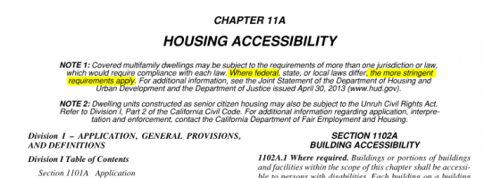

More to the point, California's own CBC-11A was based on (and in several ways exceeds) FHADM, so during the building design process, most professionals out here tend to focus primarily on 11A in the effort of compliance with FHADM.
ANSI is not code in CA.
ADAguy is technically correct that FHADM (and ADA, for that matter) is not "code" in CA, in the sense that the state did not adopt FHADM as a code and does not require the authorities having local jurisdiction to plan check utilizing FHADM.
Instead, CA plan checks to CBC-11B code for public facilities, or CBC-11A code for private housing.
Having said that, there is a preamble "Note 1" at the very start of CBC 11A, that helpfully reminds everyone to comply with the most stringent requirements of "more than one jurisdiction" either federal, state, or local laws, and it makes specific reference to a HUD/DOJ statement dated 4/30/13. That letter is all about the scoping applicability of federal FHA to private housing. See image below.
Conclusion: it is semantically correct to say that FHADM is not "code" enforced by the jurisdiction of California building departments, but is is still a "requirement" that is enforced by the federal government via post-construction civil litigation, and woe to the person who forgets this.
