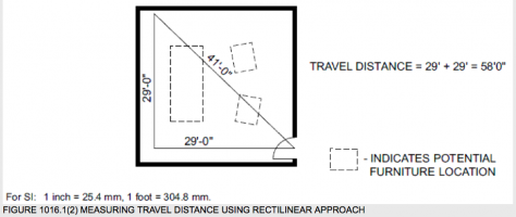

Anyone know where the source information is located for measuring common path of egress travel distance? Some say the distance is from furthest point in room along walls, others say around fixed furniture (what's the definition of 'fixed'); others say around all furniture, etc.

COMMON PATH OF EGRESS TRAVEL. That portion of
the exit access travel distance measured from the most remote
point within a story to that point where the occupants have
separate and distinct access to two exits or exit access doorways.
From the most remote point measured at right angles or the "natural path of travel" and you will never be wrong.....

I would take "natural path" to include furniture, especially fixed systems furniture (cubicles).

Agreed...I don't know any AHJs that will accept a common path measurement going through a piece of fixed furniture...

I know where the section is in the code but there are no diagrams. "Natural" path is vague. I would go OVER the furniture if I saw a fire in my space :)

Would someone in a wheel chair go over the furniture" What about senior citizen who doesn't have that level of mobility?
I show furniture layouts on all my code plans and take the furniture into account when looking at any sort of travel distance.

from the code commentary:
This table reflects the maximum distance a person is allowed to travel from any point in a building floor area to the nearest exit along a natural and unobstructed path.......

Think accessible as in unable to be vaulted in a WC. Fixed as in "attached" to the floor surface.

Just applying reality to a space, honestly, while you still can... Rooms get stuff, fixed or not, and not usually on an angle to the room. No one argues this, until they have to add an exit. Then they don't believe reality anymore... for the moment. Then code proposals get submitted to try to spell out reality in the next code, and then the book gets bigger and more defined, and then people get more lost in it, and then professional building officials get more bound to definitive words attempting to spell reality, but missed the mark. Then designers get angry the code is too black and white for their design, and they want the authority to consider reality... Kind of like they wanted the designer to when measuring human travel.
A space where people will move diagonally, measure diagonally while you can.
A space were people will move at right angles, measure at right angles before to code makes you do it every single time.
Accept the reality of all the variety, before the code defines reality by the most restrictive of the variety. That is not directed to anyone, just a general rant I've offered up...
