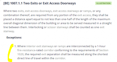

Hopefully someone can clarify this common path measurement issue to me. Think of a fire sprinkled multi tenant high rise building floor plate with a 1 hour rated common corridor that connects the two rated stairs. The suite is large enough to require two exits. My confusion/concern has to do with the termination of the measurement for "Common Path". We have typically measured this to the suite exit doors that enter the 1 hour rated corridor. A Fire Marshal has just given us a correction that the common path measurement needs to continue to the stairwell door. We have a 100' max common path per code. We cannot both paths to the exit stair door within 100'.
Is that the correct way to measure common path, and do both paths to the exits need to fully from CFC 202:
The definition of "Common Path Of Egress Travel in CFC 202"
It sounds to me like once you are in the corridor, and you can choose to go left to stair A or right to stair B, you have reached the termination of the common path of egress travel.

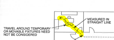

Regarding previous posts on whether loose furniture constitutes an obstruction, I found this old reference in the 1997 Handbook to the Uniform Building Code published by the then-ICBO, stating that exit travel measurement distance already factored in the potential presence of "tables, chairs, furnishings, cabinets, and similar temporary or moveable fixtures or equipment, allowing a straight line of travel over them. In other words, "unobstructed" already assumed that furniture could get in the way, and "travel around temporary or moveable fixtures need not be considered".

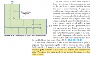

Interesting. Exact opposite of what is being put forth today. This from the 2018 Building Code Essentials:
The suite doors into a corridor don’t cause an end to the common path if you are in a dead end.
