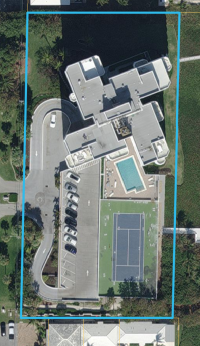

We considered this but it would require complete building plans.
From a zoning standpoint they don’t care if a use is actually being used or not, it potentially could be used.
Any money (and time) invested in this process should increase the property value, and it looks good in an advertisement. "Ready to build" or "plans approved" will tell the shoppers that this property is ready for construction and not in the middle of a lengthy code enforcement process.We considered this but it would require complete building plans.
Great idea. Remove the pool equipment, fill the pool with sand then use sod to put grass over the top and wala. The problem goes away.Might I suggest that you fill the concrete shell with dirt.
That will be enough to disappoint the Building Dept. Could be they will disappoint you back. I mean, you know... just thinking out loud... about how I ... well anyway. That sorta sounds Presidential.Buy the cheapest set of plans you can find from one of the on-line plan selling services. If you don't intend to build it, it doesn't matter what plan you choose.
No need to remove the equipment. Put a cover over it. If you ventilate it, you can leave it when the pool is restored.Great idea. Remove the pool equipment, fill the pool with sand then use sod to put grass over the top and wala. The problem goes away.
Here you would have to get a demo permit and we would make you compact the soil in lifts, special inspections and soil report, and perforate the bottom of the pool to allow drainage. If you did fill it without all of that, we would be likely to disappoint you...That will be enough to disappoint the Building Dept. Could be they will disappoint you back. I mean, you know... just thinking out loud... about how I ... well anyway. That sorta sounds Presidential.
A community pool is a pool for a neighborhood. That may be a regional term but we had a lot of them in South Carolina and there a few of them around here in Louisville. Membership for some of them are covered by the HOA dues and some of them are covered by a separate payment if you want to join.What do you mean by "community pool?"
A public community pool, has essential support buildings like bathrooms, changing rooms, and storage, should be considered a primary public recreational use, not an accessory structure, because it aligns with the intent of zoning regulations to serve the community’s needs, promote public welfare, and falls under the municipality's authority to develop and manage public facilities.A community pool is a pool for a neighborhood. That may be a regional term but we had a lot of them in South Carolina and there a few of them around here in Louisville. Membership for some of them are covered by the HOA dues and some of them are covered by a separate payment if you want to join.
Some city's adopt an ordinance (law) insurance hold back, like 10% of the face value of the insurance policy. Those hold-back funds are then dropped in an interest bearing account. After the structure (HOME) is demolished the funds are released to the property owner with any interest accumulated. I would think your pool would be insured under you homeowners policy? With that said, I would think the city would have to release those funds if the main structure has been demolished. Those funds IMHO are being held hostage if demo is complete and the city very well may not have a legal standing.I don’t know why the escrow account was established, but I’d be surprised if one of the terms under which the money can be released is to demolish your pool.
