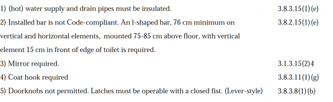

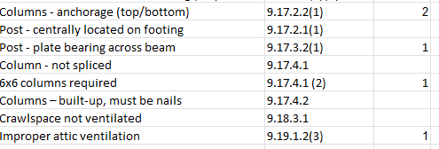

I've seen some commentary that providing code references is too time-consuming. For frequent infractions, it's not too hard to have a 'cheat sheet' for things that are screwed up regularly.
When a more complex violation is found, going to the code reference is an exceptional way of verifying "am I right?" For the seasoned inspectors who are experts in their area of code, it prevents the "oh, crap, that changed with the 2015 edition???" failure; for the rookie, it's a valid way of ensuing that hey, I'm right.
This is an example of an inspection report from our office.
This was for a barrier-free (disability access) washroom. It took me maybe 45 seconds to write (2), which I did because I'd given the contractor and the owner all of the documents/guidelines to meet Code, and denied the application until the designer had given a Code-compliant breakout, and they had still frigged up. Writing the report took me - if I exaggerate - six minutes. That six-minute process also included uploading the report and pictures to our cloud-based server, which emails the client and contractor with the report.
