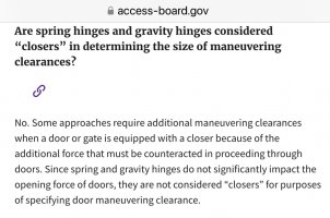

I would argue that spring hinges are a "closer".....
Ultra Vires
Where can I get that on a hat?
Yikes, I too have examples of wrong corrections that resulted in unnecessary expense and delay. With some of it I can prove that malice aforethought was present. When I turn something down, I am on solid ground and will line up the ducks. I procure validation and proceed with Intra Vires.
In CBC 11B and ADA, a "spring hinge" (404.2.8.2) is not the same thing as a "closer" (404.2.8.1).
I assume you are talking about closing speed, and even though they are treated differently there, they both close the door and IMO require the better maneuvering...Unless spring hinges exert that much less force and can be quantified somehow..
The additional maneuvering space requirement is based on the fact that the user needs to exert more force and perform a combination of movements to open doors that have both a latch and a closer. A door that has a latch but no closer can be opened by the user disengaging the latching mechanism and pushing with the hand, with the door remaining open during passage. A door that has a closer but no latch can be pushed open by the momentum of the user without requiring additional hand or arm movement. Typically, this is accomplished by pushing the door open with the feet or wheelchair footrest. For a door that has both a latch and a closer, the user must perform all of these movements simultaneously, which requires additional maneuvering space. Figures 404.2.3.2(B) and 404.2.3.2(C) illustrate the requirements for this type of door use.
