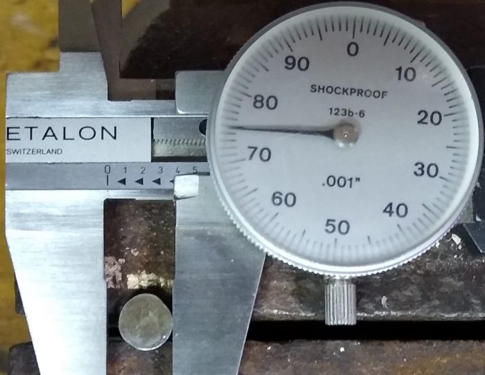

I have been searching online for anything about roofing nails with heads less than 3/8" diameter and find nothing. Going to a big box store later and will take a tape measure.

ok everybody go by a roof job today
Check mail size
Post a picture
Okay, cda, I did what you instructed me to do, and the job I checked the coil nails looked like the picture on the right and measured 3/8-inch. Measured with an official Stanley 25' fat max tape measure.
  • Like
Reactions: cda
I've checked several re-roof jobs over the last few days and all of them are using the standard roofing nail I would expect to see. I talked with the leads and nobody has seen, or even heard of, a smaller nail being meant for asphalt shingles. A mystery for sure.

GAF got back to me and said that the manufacturer defect warranty would still be in effect, but if the damage was caused by the fasteners that they wouldn't cover it. So no 110mph wind warranty, that's for sure.
Spent some time with the building inspector today. He's very interested in the nail head discrepancy and is looking further into it, but couldn't give me an answer straight away. Turns out that I didn't need to fear being embarrassed at all, as all of my concerns have some validity and you guys were right, they more or less stick to the manufacturer instructions - which the installer failed to follow in way too many instances.

The job is done and, from what I can tell, done pretty well the second time around.
They ended up using Bostitch CR4DGAL coil nails. They're still a bit small, with heads varying from .350" to .370", but much better than the generic ABC Supply nails that were originally used. Having looked around at local building supply stores and not finding any coil nails that are actually .375", I'm thinking that these Bostitch nails are about as good as coiled nails come these days.
While I'm much happier with this second new roof, it still bothers me that the commonly available and commonly used nails fall short of minimum code and manufacturer requirements. Why have a minimum spec if it is not going to be, or maybe even can't be, adhered to?
Pic below shows an original (.380"), a Bostitch (.360"), and a generic (.325")
