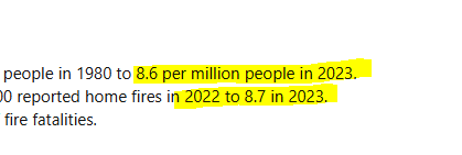

Do you think this has anything to do with codes?
Trends in residential fire deaths
1980 vs. 2023: The home fire death rate dropped from 23.0 per million people in 1980 to 8.6 per million people in 2023.
2022 vs. 2023: The rate of home fire deaths increased from 7.5 per 1,000 reported home fires in 2022 to 8.7 in 2023.
Regional differences: The southeastern states have the highest rates of fire fatalities.
I suspect the long term drop does to some degree. Detectors and educational work reinforcing the code requirements. I don't consider the one year bump to mean very meaningful. No explanations from the source?
I.O.W. the fire death rate dropped to 1/3 of its 1980 levels. But were there major innovations in life safety codes for residences during that time?
Or were the other cultural factors at play? I know type X gyp became a bit more prevalent at big box retailers.
What about smoking?
In the late 1970s, 38% of American adults smoked. In 2022, 11.6% smoked, a drop of about 1/3. Correlation, or causation?
Regional difference: the southeast also has the highest percentage of smokers.
I think comparing a 43 year trend against a one year interval is statistically meaningless.
