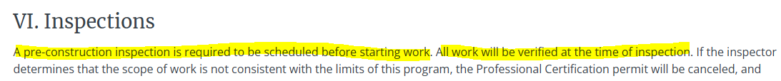

City of San Diego has a professional certification prog5ram for tenant improvements that works well. It is pretty limited to what qualifies, but it is simple and efficient.
Professional Certification for Office Tenant Improvements
This information bulletin explains the process for the Professional Certification program for office tenant improvement building permit projects.www.sandiego.gov
Pretty sure that was up the street from me in Mass....Unless it has happened several times...
Don't think I understand how this works?City of San Diego has a professional certification prog5ram for tenant improvements that works well. It is pretty limited to what qualifies, but it is simple and efficient.
