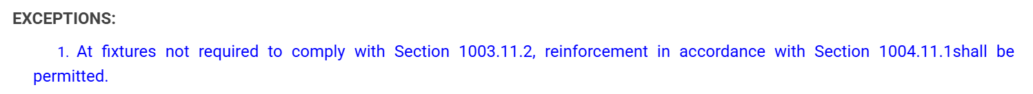

Think about this exception in 1003.11.1 for a minute
Where exactly would you install reinforcement per 1003.11.1?
