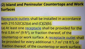

Almost every island/penisala will require multiple receptacles..

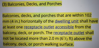

Decks are mentioned here. Jeff is excited about decks.

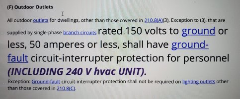

They don't seem to know about "extra duty" in use covers over outdoor receptacles too.

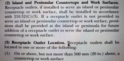

2023 NEC No longer requires island or peninsula receptacles, but id you have them they have to be above the top of the counter...
Here is the 2023 NEC. Note that the code says if installed it shall be on or above the countertop. It goes on to say that if a receptacle is not provided it shall be installed anyway.
It makes me wonder if the committee members came to blows before they reached this impasse.
