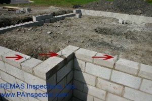

    Where do we even start? Even the layout is wrong.

    right not the layout seems to be wrong, nothing to keep the carpenter from drilling and setting appropriate anchor such as epoxy bolts correctly.

    Anchor bolts in wrong locations. Should be 12-inches from each corner, I count TWO corners.
    Anchor selection and depth? One appears to be low and may not catch the sill plate material.

    A "no-super" job?

    We always jab them into the wet mortar. You’re the first person to complain, eveyone else says they are fine.

    Jabbing anchor bolts in wet concrete is not fine and any contractor who says it is ok should have his license revoked.

    Mark ... sarcasm
    And those bolts are in mortar, not concrete, i bet the pullout strength is very low.

    Block construction apparently creates anchor placement issues that conflict with the code requirements. But like someone said, come back and add some drill type anchors to appease the inspector?
    On poured foundations and slabs, we don't typically see the blue anchor bolt standoffs used here, L-anchors are wet set here 90% of the time.

    Setting into "wet" is one thing but into CMU is entirely another.
    Do regional methods and means differ, to some degree but to code minimums, debatable.

    While I said concrete I could just as well said grout. For this discussion there is no difference.
    Am not aware of any code that has provisions for anchor bolts or anchor rods in the joints between masonry units. So why are they accepted?
    All the concrete block construction that I have sees uses hollow block where the cells can be filled with grout. The bolts are then inserted in the cells before the cell is filled with grout. The picture suggests that there were hollow cell blocks on the project.
    Just because it is a regional practice does not mean that it makes sense or is code compliant.
    There is a phenomena know as normalization of deviance. This played a significant role with the failures of steel moment frames that we found after the Northridge earthquake. What happens is that if people accept deviations from the code too often the deviations are seen as the new normal. The process repeats itself.

    As far as my opinion on the original picture posted, not one bolt would be compliant in any way, shape or form. You can't cap with 4" solid and slip an anchor bolt in between a joint on top of the joint of the block below and think you are anywhere near compliant with the code. If you are the kind to approve this, you are not doing your job.
