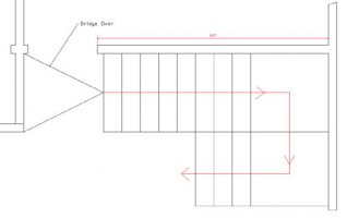

My prior post is directed at the latest 2009 walkline wording for the defined location. If you check out the commantary it is specific for using the widest point within the flight, not the shortest, hence my drawing.
The 06, though does not define location of walkline in a fixed term location, it leaves the door open and thus one need be creative and conclude that the walkline is just 12" in from edge.
Lynn, you are correct about the 6" on the outer side, that is normally fixed with just doing a 45 degree turn out 6" from the wall, I did not draw that in my sketch, figuring it was a given, but I guess I should be more detailed. This turn out also takes care of the wall post for termination of the guard.
The point I was getting at is by doing more than 2 interlocking winder treads, and meeting the 6" min edge depth, you will end up eating up more travel distance than adding in a landing, unless you are doing a descending 180 degree wrap, but then you would still extend out further than a landing turn on a 90 degree layout vrs the 180 return for full descending.

Glennman, yes, I saw a clarification of that during my reading of 311.7.4.2 of the '09. "Consistently shaped winders at the walkline shall be allowed within the same flight of stairs as rectangular treads and do not have to be within 3/8" of the rectangular tread depth." That has been my understanding of the intent, and I do agree with it. Don't misunderstand my sentiments... despite all my oscillations I'm not a winder fan.Tom, thanks for bearing with me and clearing up some of the terminology and measurement points. I've attached a plan view, it is 9'5" to the bath door but I'd like to keep the overall run in that direction to 9'3 max. The finish floor total rise is 108". The entry is fairly close @ 6'5". The lower run is also 38-1/2" wide which should pass min clear width between the newels. The constraint is the clients' desire to make the lower run into the floor as short as possible in the entry area. So yes, if the winder on the landing is as short as it can get, that is the solution. They were pushing for it being more compact and asked if we couldn't put another winder on the landing and buy more room. That was my next round of sketches, exploring if that could work. That side journey also exposed a real weakness in my understanding so I'm also trying to fill that gap. I gather that after a single winder on the landing I'm growing as compared to minimal rectangular 9" treads stepping off the landing?Thanks again,Don P
/monthly_2010_09/baldwinstairSept28b.jpg.ab3e3ab86bbeb8796ef59008ec616463.jpg
I'll make this another post so it'll be easier to say "disregard your last post, thinking problem".Let me see if I understand some concepts. I drew the baluster line 1" inside the newels on both flights. I then drew a line inside that 12", from both the upper and lower flights. I then swung a 12" arc that is tangent to both 12" lines. I added another winder. I swung a 6" arcfrom the corner of the newel to make sure I had 6" at any point on the tread below it. I measured and balanced the length of chords across the arc and down the lowermost winder (Is this the correct way to measure that?). I also nipped the corner of Lynn's tread (That actually looks like its more likely to cause trouble to me?)If that all worked it did save almost 4 more inches.

You have met the techinal portion of the code, however, it is really not that good of a stair layout for functionality.
You noted that the doorway was a bathroom, so this might not work, but what if you shifted the stairs to the right and put a double descending platform with a 180 degree turn, and shifted the door to be under the staircase rather than at the base?
I don't have the whole floor plan, nor know were in the construction phase you are, but, this seems awfuly tight fit and the stairs are being shoe horned in place.
You also might want to think of changing the guard and handrails from wood to metal, this would save you on post width and clear width concerns by about 3 - 4 inches.
The following layout would be a better walking surface
My skecth mostlikely involves a lot of fixture moving at this point, so it is mute, but just what I would see to solve the tight turn.

Mostly I'm glad to have finally wrapped my head around the technical aspects. There is actually a bathroom behind that door but there is a closet behind the doorway you've drawn. Your design can work in the original location, that sketch was shot down as well. I'm in the position of presenting the options and explaining the virtues and drawbacks of each. In the end I will build a compliant stair of their choosing. The bright spot is that I know the designs offered are code compliant, the original design was not.
