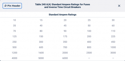

In 2023, we see the addition of a 10A circuit breaker to NEC 240.6. Who can tell us why this 10A breaker was added? You might find some relevant information on some of the previous electrical threads.
So don't be surprised if you see 10A breaker during your next inspection.

They did not add 14AWG copper clad AL to the 2023 NEC. Not that that is a bad thing.
240.4(D)
(D) Small Conductors.
Unless specifically permitted in 240.4(E) or (G), the overcurrent protection shall not exceed that required by 240.4(D)(1) through (D)(8) after any correction factors for ambient temperature and number of conductors have been applied.
(1) 18 AWG Copper.
7 amperes, provided all the following conditions are met:
  • (1) Continuous loads do not exceed 5.6 amperes.
  • (2) Overcurrent protection is provided by one of the following:
    • a. Branch-circuit-rated circuit breakers listed and marked for use with 18 AWG copper conductor
    • b. Branch-circuit-rated fuses listed and marked for use with 18 AWG copper conductor
    • c. Class CC, Class CF, Class J, or Class T fuses
(2) 16 AWG Copper.
10 amperes, provided all the following conditions are met:

(3) 14 AWG Copper-Clad Aluminum.
  • (1) Continuous loads do not exceed 8 amperes
    • a. Branch-circuit-rated circuit breakers are listed and marked for use with 14 AWG copper-clad aluminum conductor.
    • b. Branch-circuit-rated fuses are listed and marked for use with 14 AWG copper-clad aluminum conductor.

I was wrong, thanks for setting me straight.
2023 NEC 310.3(A) still says "The minimum size of conductors for voltage ratings up to and including 2000 volts shall be 14 AWG copper or 12 AWG aluminum or copper-clad aluminum, except as permitted elsewhere in this Code."
Also, Table 310.16 does not list an ampacity for #14 Al or CCA.
So maybe a bit of disagreement between the CMPs for Article 240 and Article 310 on the topic? I don't think you can use #14 CCA for general branch circuit wiring under the 2023 NEC.
Cheers, Wayne
