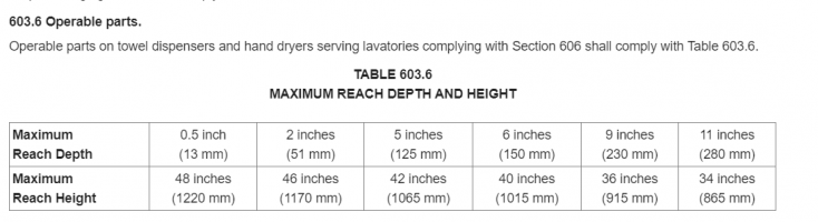

Hand dryer come with recess kits or a 4" slim line version, Toilet paper dispensers come with a recess to prevent more than 4" protrusion - also the ICC ANSI/ ADA give special exceptions to certain items because they are allowed...... However, the shelf (rack) system depicted earlier is not allowed.
Also to install items above the sink as indicated, a certain amount of reach is allowed as per ICC ANSI Table
