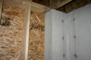

As you can see, this is not the best transition from a poured concrete foundation to an exterior wall of a walk out basement. What code issues do you see? I will throw in the photo from the bottom of the wall too. Click on the photos to enlarge.
In pic 1 ... double top plate does not extend over the concrete wall, and the i-joist is sitting on the concrete ... secured with concrete nails?
Sometimes we see a TYP foundation stud and sometimes a white wood stud with sill sealer.
Is the I-joist on a treated sill?
Double top plate end joints should break a 24-inches
TYP bottom sill anchoring? Looks like they used concrete nails and plumbers strap?
