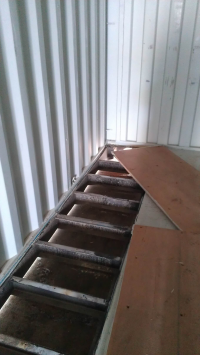

Type IB - rated floor assembly required over crawl space?
Although, I think most shipping containers use wood sheathing for their floor (either nominal or 1" T&G marine-ply). This could have been another issue with the Type I-B designation.
Yep...back to the earlier note.....But honestly I don't think they are "structural wood", just a wood finished floor...
From the ones I've seen, there is a steel member acting as a joist, and the wood floor is acting as sheathing.

Just reclassify the construction to Type VB if thats doable, it should have been done that way in the beginning. If the areas work, there should be absolutely no reason to have to permit a single story structure above VB.
The AHJ should be amenable to that as long as you meet all the life safety requirements. I recommend giving them a phone call to walk them through it however.
Edit - you can't use plywood in Type I/II type construction. You would have to use metal deck, concrete or something like DragonBoard (Mag Oxide panel) to achieve a noncombustible and fire rated floor decking.
US Gypsum makes 3/4" thick structural panels that are cementitious. I believe they would be acceptable in Type I construction. They should certainly be acceptable in Type II construction.
Yes, Structo-Crete meets ASTM E136 testing for noncombustible material.

Correction....there are limited uses for plywood in type 1 and 2 construction...not allowed for a structural subfloor but can be used as a floor finish...
