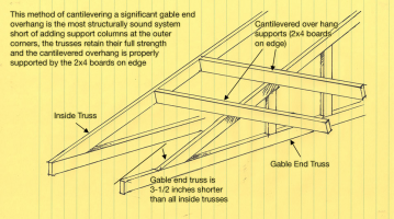

This typical drop top chord gable end truss typically what we see around here. 36' to 40' spans are common and a 45psf roof snow load and 115 mph ultimate wind speed exposure "C".
Question If this truss Has a 2 ft tributary load on each side and all of the supports for the top are vertical how is that not transferring the top chord loads evenly to the bottom chord and thus to the wall? Is it less than 100 lbs per linear foot and therefore of no concern?

Most of the verticals in the gable truss drawings I looked at considered a load of less than 250lbs at each vertical. I think this is probably a calculation based on the overhand designed into the truss and the tributary load from 1/2 of the truss spacing. IMHO, these trusses are bearing. Does that mean that prescriptively we are going to require a built up header? Typically not for me. And even if I wanted to, there doesn't appear to be a table for trusses bearing parallel to the building width. (Never really liked these tables, but they are what we have). In the OP, it sounds like the inspector and/or the boss didn't have a clear understanding of this, and then everyone dug their heels in. If there are truss design drawings I think the issue could be resolved rather quickly...if personal feelings and opinions can be put aside. My comment was based on the contention that they are typically non-bearing. Some trusses require continuous bearing ( for various reasons as others have noted), some have concentrated loads.
In the 1st drawing, the hatched bottom chord indicates a requirement for continuous bottom chord bearing, which is verified by note 7.
In the second drawing, even thought the truss looks to be symmetrical, one side is clearly non-bearing, but the other is bearing. And, in fact, joint 12 has considerably more reaction than the similar joint 9, which has no bearing requirement.
I am not an engineer so maybe my understanding of these drawings is wrong. When I inspected I required the layouts and shops on site. Even though I typically considered a standard gable truss as "non-bearing", I would look for the hatch, and if I saw it I would consider why.
The truss is just the trusses. It is not the wall. The picture doesn't show the wall itself. Typically, the load bearing walls would be running in the same direction as those cantilevered overhang supports and at a point likely where the gable end truss top chord joins the bottom chord. No wall or any bearing wall would not necessarily be needed running in-line (parallel) with the bottom chord. The bottom chord of a truss does not typically required to have intermediate walls or other supports under it other than at or near the end points. You're trusses may overhang and the load bearing wall in maybe about 18" to 36" or so in-set from the very end of the trusses at bottom left & right corner. Any wall under the truss except those running perpendicular to the direction of truss span (end to end), normally, does not require load-bearing walls or any wall. Those walls, posts&beam systems, etc. are more for moisture envelope and subdividing the interior spaces into rooms or defining function areas. Those vertical studs are not normally requiring to transfer through to ground. You may, if you want to. You can have a wall under it with double-top plates.

It's stamped by an engineer. Consult the engineer and do accordingly. Any window or door under the 'hatched' "continuous bearing support" should have header beams over the window. The areas that do not have a continuous bearing support requirement, does not necessarily require header beams over the window. If any portion of a door or window is under that continuous load bearing area, you should have a header beam continuous over the window and door. Like I said, consult the engineer that stamped the drawings.
Usually walls in-line under the truss's bottom chord is not required to be load-bearing. This is because trusses do not usually require continuous load-bearing support running in-line with the truss. Typical roof trusses are bearing load on each end within 5-ft. from the end of the trusses on each side and those run perpendicular to the direction of truss span so the continuous bearing wall supports each truss on that end. Maybe I'll have to sketch something to illustrate.
