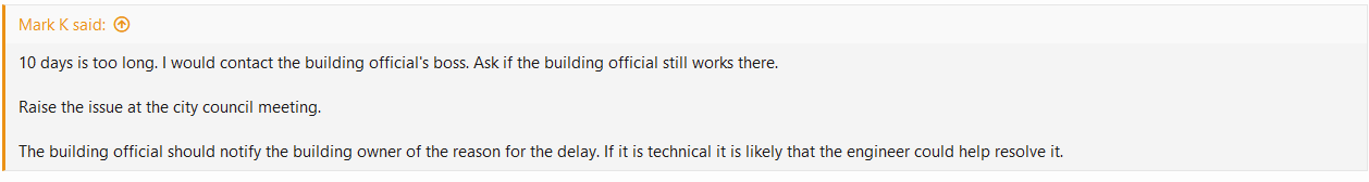

10 days is too long. I would contact the building official's boss. Ask if the building official still works there.
Raise the issue at the city council meeting.
The building official should notify the building owner of the reason for the delay. If it is technical it is likely that the engineer could help resolve it.
