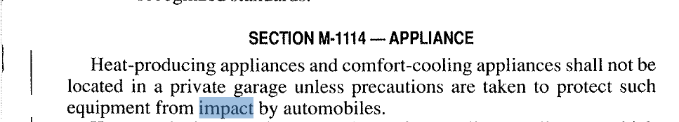

Well ICE it is a slow afternoon here in the office so I thought I might use your response and head down the rabbit hole on this subject.
The requirement mentioning vehicle impact protection is a carry over from the CABO Legacy code and that is one reason why you find similar same language in the IRC and IFGC. Below is from the 1982 CABO code notice it mentions heat and comfort cooling appliances that would include electrical AC units. In the Legacy codes Fuel Gas requirements where part of the plumbing and mechanical codes and protection
Impact protection is not limited to garages or vehicles or between the fuel requirements of the appliance. It can be Electric or Gas or Oil since the IMC regulates appliances and exhaust systems that contain large amounts of various gases and flammable materials that are harmful or deadly to people and the environment if not contained impact protection is required.
