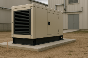

I've only seen a handful of installations that required this. As a matter of fact, I can probably count them on one hand. There are situations where ground rods are required at a generator. Who knows the answer as to under what circumstances ground rods are required at a generator?
When it is a separately derived system
Does not require ground rods at the generator, merely requires a GEC (Grounding Electrode Conductor) to a GES (Grounding Electrode System). The adjacent building's GES could be used. In fact if the generator is sufficiently close to the structure, any ground rods you install for it must be connected back to the building's GES.
The only requirement I can see for a ground rod at the generator itself would be 110.3(B), if the listing standard requires one. Of course, until the 2020 NEC generators weren't required to be listed.

And what is that sufficiently close dimension in the NEC again?....Yes, they could use some other grounding electrode, such as rebar in the concrete supports, but my point was that it did not need it's own GES unless it was an SDS....But even that answer could be a little fluid...

I started this thread to educate, not debate technicalities. Far too often, I’ve seen inspectors call for ground rods at generators without understanding why. Many don’t know what a separately derived system actually is, let alone when it applies. Most residential inspectors may go their whole career without seeing one. And yet, they’re out there calling for ground rods by default, even when the generator doesn't require it. Meanwhile, they’re missing the bigger issue, like a neutral-to-ground bond in a non-SDS installation, which I’ve personally found on follow-up inspections.
The reason this matters is that education doesn’t come from just quoting code; anyone can open the book. It comes from understanding how the system works and knowing what to look for. A generator with a 4-pole ATS is a clue. A switched neutral is a clue. The bond location inside the generator is a clue. But none of that gets caught if the inspector doesn’t know what they’re looking at.

That's how I've looked at it. They could install a ground rod because the plans called for it, or the manufactures directions call for it. I don't think the code will tell us that it is required, but it will tell us that it's allowed. The inspector needs to know how to look for other violations IF they have installed a ground rod. Is there a neutral to ground bond at the generator? At the switch? Is the neutral transferred at the switch?
If I see a ground rod at a generator, and a neutral to ground bond anywhere on the generator side of the switch, then that neutral better transfer (disconnect) at the switch along with the ungrounded conductors.
I think that before I run a grounding electrode for a generator, SDS or not, I would have to reflect on the possibility of accidentally creating a difference of potential/electrical gradient between the generator electrode and the system electrode in some possible instances/scenarios.
