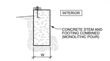

When does a “stem wall” that is part of your foundation become a “concrete foundation wall”?
Joe.B
Dec 4, 2020
935
Myrtletown Ca
Assuming a prescriptive residential code design (no RDP stamp) and assuming seismic design category D or higher.
I have always looked at Section R402.2 and Table R402.2 and determined that the minimum compressive strength for a foundation is 2500psi.
The following section was brought to my attention:
R404.1.3.3.1 Compressive Strength
The minimum specified compressive strength of concrete, f 'c, shall comply with Section R402.2 and shall be not less than 2,500 psi (17.2 MPa) at 28 days in buildings assigned to Seismic Design Category A, B or C and 3,000 psi (20.5 MPa) in buildings assigned to Seismic Design Category D0, D1 or D2.
I am interpreting this as when prescriptively designing “Foundation and Retaining Walls” per Section R404 then the minimum compression strength needs to be 3000psi vs. 2500psi. The problem is that code doesn’t tell us when a foundation becomes a foundation wall. My gut intuition is that anything up to 24” above grade would just be a “stem wall” that is part of the foundation, and not a “foundation wall”. I would start calling it a “foundation wall” above that height.

For example, in the image I posted (prescriptive in seismic design D) would that "stem wall foundation" be required to be 3000psi or is 2500 acceptable.
Yeah, the issue I'm having is that all of the references in R402 and elsewhere in the code reference 2500psi. Buried in R404 Foundation and Retaining Walls is this requirement to go up to 3000psi. If the need for the "foundation" (footing and stem wall) to be 3000 then why doesn't that show up in 402?

To your thread title question, I believe a stem wall is always a foundation wall and has to meet those requirements.
I'm kind of leaning that way too, as long as it doesn't then trigger a special inspection. If the reference ICE pointed out means this would trigger a special inspection then I'm leaning towards not calling it a foundation wall unless it crosses some undefined threshold. I say undefined because code doesn't define it for me. If I'm left to make the call then I would say it would become a foundation wall if the grade on either side is substantially different, or if it's more than 18" above grade, or if it separates conditioned/unconditioned space.
All footings for walls below grade are part of the foundation no matter the height of the wall, if there is unbalanced backfill or constructed of concrete masonry or wood. Whatever you call the wall it is part of the foundation that braced wall panels, alternate bracing and other above ground connections are relying on for them to work properly in a seismic or high wind event.
As far as a special inspector for 3,000 psi concrete one is not required under the IRC.

I don't know but maybe you guys do it differently there but the picture that I posted is how it is here ...monolithic...the foundation and any assumed wall is all part of the same pour.....wall and all. Given that the footing is 3000, so is the wall.

What about the stem wall? Usually both are done in one pour around here.
Steak dinners all around. When you question if a stem wall is a foundation wall, ask yourself if there is a difference beyond semantics. If the wall is supporting a building it seems to me that it functions just like a foundation wall. I find it impossible to fit a stem wall into the construction that would not.
So the status quo is to accept batch tickets for the record and unless someone says "foundation wall" it's not. Why upset the apple cart? It is imperfect but so much of what gets done is. Has there been a problem? An arbitrary dimension for the height of a stem wall that converts it to a foundation wall is not better that allowing what has been the norm for a long time.
The detail I posted in post #3 was just an example, not specific. That picture does represent what I usually see, but as a monolithic pour. I've never seen what you show in post #7.
