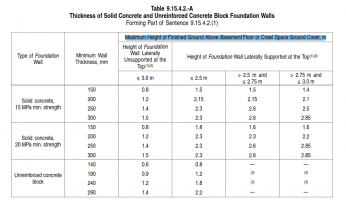

Sometimes the answer can be found by flipping the question. OP asked when a stem wall became part of the foundation. My immediate response was to ask "when is it NOT part of the foundation?" That might be my Code training coming into play, since Canadian Codes consider above-ground walls to be part of the foundation, in general. Height is regulated as a function of wall height, fill height, wall thickness and concrete strength.
Is there nothing like that in U.S. Codes?
[Those inclined to self-abuse can see the gloriously metric table attached, which may not be tremendously useful to those in the Excited States, but it does show quite clearly that your northern neighbours (not "neighbors", you will note) consider a "stem wall" to be part of the foundation wall.FYI, 15Mpa=2,175 psi; 20Mpa=2,900 psi}
