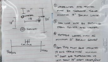

The picture is a correction written by a Senior Building Engineering Inspector employed by LA County. He found a plastic water pipe, ABS sewer and coated steel gas pipe all together in one trench. With his 22 ICC certifications he was able to identify a non-issue with a correction notice.
In have hundreds of examples of bogus corrections written by the engaged multi-discipline code experts. The newbies with their three certs are not writing bogus corrections .... they avoid that mistake by not writing corrections.
