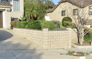

There are reasons for not obtaining a permit. My yard used to slope towards the street. It was grass and rabbit turds. More turds than grass. The city offered to pay me to remove the water hungry turf. So I got a building permit and built a retaining wall. The inspector came for the footing inspection while I was cleaning out the excavation with a ShopVac. He said that he's never seen anyone so meticulous with a footing and therefor he didn't bother to look at anything. He signed the card and away he went.
He returned several days later and crossed his name off the job card. He said that the wall shall be set back two feet. I showed him the approved plan that has the wall right where it is. I had the first few courses of CMUs in place and this inspector is telling me to start over. I called the BO and explained they had a shot at it and missed the target. He said that he would let it stand if I grew Ivy on the face of the wall. As you can see, I declined.
For a few hundred dollars and my time I had a dolt show up and waive the inspection. Since then I have replaced both HVAC systems, french doors with sliders, overhauled two balconies and a repipe without asking the city to be a part of it.
The point of the story is that code compliance abuse works both ways. I have seen the light. Okay I admit that I am not the typical civilian that should rely on a code professional to evaluate the result....but those civilians are just getting screwed...twice.

The first picture … does it bother you having the retaining wall right on the edge of the driveway? Seems like it would make backing out of the drive a little awkward.
I back in. My wife backs out. Her driving is more than a little awkward. She parks far enough to the left that it’s safe to back out. Thankfully, there isn’t much traffic on our street.
